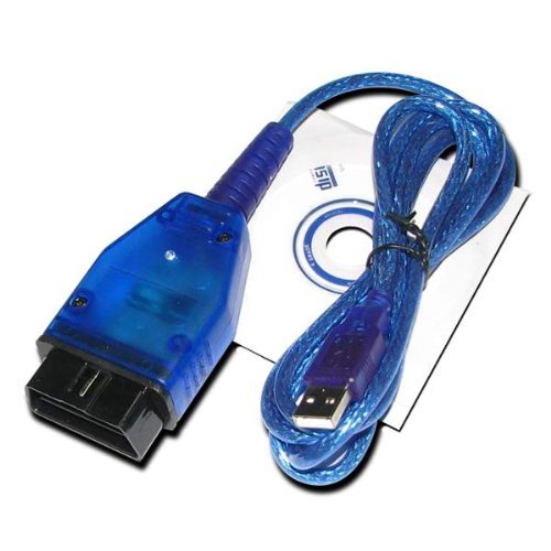

+1. good thread. reminds me i need to do something about getting the bits i have working. i've got an usb obdII cable similar to the one on post #128 by xcrave and for obdI an ADS interface from miglenium. just haven't got round to installing the software after changing laptop. switched to an old model latitude d630 for its native serial port. also it's got more processing power and memory compared to the x41 i used earlier.
