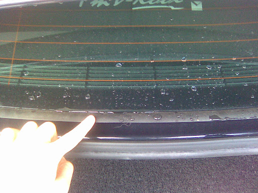

Anyway, i m referring to this piece. once u open the boot, u see a long rubber..as pointed
Seen this piece peel off before also affecting front windscreens (on top area near the roof) on the E90 (another member's car). Its a known issue with the E90 which affects some cars (CKD and CBU) and likely heat/sun related. Get it replaced underwarranty ;)

Is the strip clipped on or glued?
Same thing happens on mine Rachel, and mine is not an accident car for sure - it had 2 km on the clock when I took delivery. Each time it slips off, I just push it back on. Doesn't bother me much, but I WILL bring it up during my next service.
It's just a slip on rubber sleeve, astro. No glue or clips.

its like that one...on my car also same...easily come out...just align it back...
Rachel, I did an oil change service and complained about my long rubber piece that keeps slipping out. Apparently it should have 3 clips in it that must have dropped out. Happens often it seems. They put in new clips and slipped my long rubber piece back into place for me. :)
