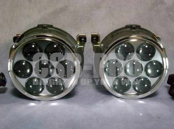

Jarance, are those LED projectors???
No lar, they are just the retrofit lens for your halogen or HID bulbs.
I have not try them or see them in action but one of the forummer mentioned his friend ride have fitted it when he went to Taiwan. he say it is canggih and he is thinking about it for his e39.

easy, u guys want bright headlight, throw away the e39 projectors in the dustbin. find a car that u think has very bright light, then get the projectors n retrofit..........
A good suggestion but sure consume a lot of time. See which day i beh siok my headlight then i will retrofit the Waja projector.
bmw7833, to open the e39 headlights does not take a long time.
to retrofit takes a long time if the shape n dimension of other projectors are different.
but for waja, it's plug n play.........
if u are planning to retrofit, better if u have the steel/aluminium headlight adjusters......go n buy or make one urself.....
before u retrofit, it's better for u to see that particular car with hid in action at night. make sure u fully satisfied with the brightness, then u retrofit. otherwise, u'll regret later........
brightness is subjective matter. bright to me might not be bright to u........
after u retrofit, then u can plonk in any wattage hid that u want, 55w , 100w etc etc.......
as for me, i have waja, i installed hid in my waja n found it brighter than my e39. so, next possible cheapest step is to retrofit lah.......
eddiefiola, if you have any pics of your retrofitted projectors will be nice if you could share it with us.
Pretty tempting to go get a set of projectors for my ride.
