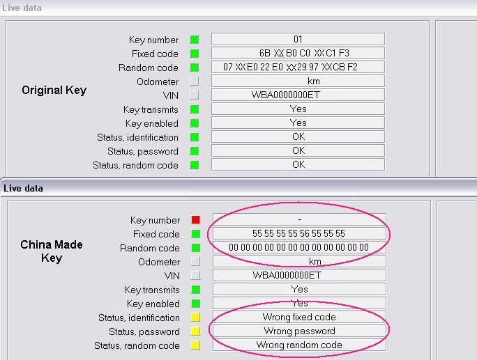

Anybody know how to solve the EWS problem.
Bought a key from china. Key can sync with the car. Can open/close the door lock but cannot start car.
Check the key information and found the info is different from the original. Anyone know how to resolve this issue.

I have the key writer as well, anyway your key can only open the doors because that is controlled by a different transponder. To use the key to start your car you need to read the key, if it is not closed yet.... remember the password for future reference. Then you will need to write it to your EWS.
If you still don't want to use the key then maybe you can consider donating the key for research purposes.... now I have one spare EWS and DME. This experience has put a lot of knowledge in my brains ....

China made one la.... EWS editor... thinking of getting AK-90 instead the EWS editor will require the removal of 2D47J chips. the AK-90 has an adaptor to read the chip without removal
