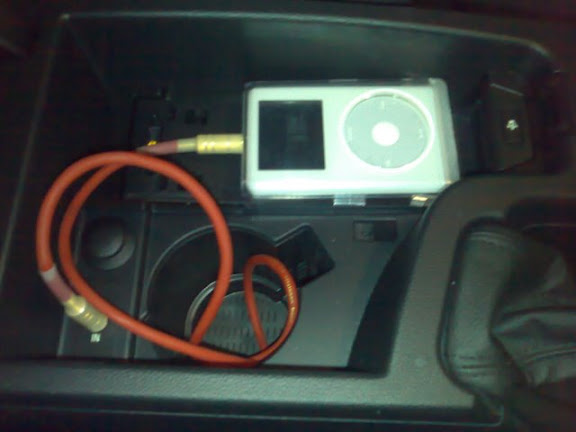

I finally got an ipod fix to my car. cannot believe it...just a simple cable, input aux. i can still interchange to cd / radio at anytime. the selection of songs must be done at the ipod though. the cable is a good one so cost quite a bit, but the quality of songs, even though mp3 is still very good...
