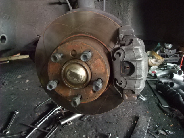

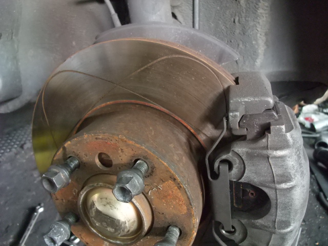

Brakes sourced by Albert from WP Auto. Very cool pattern on the disc.

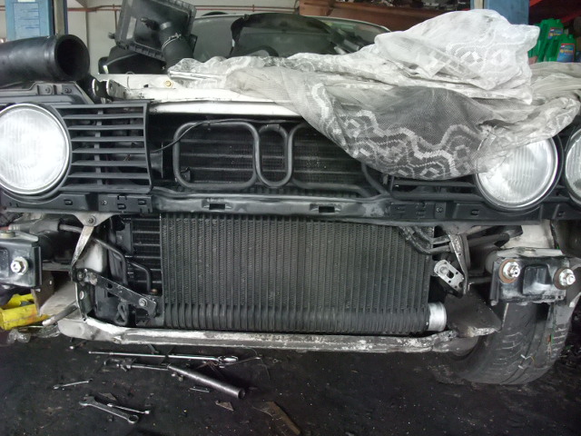

Intercooler installed. Going for the 'stock' look:

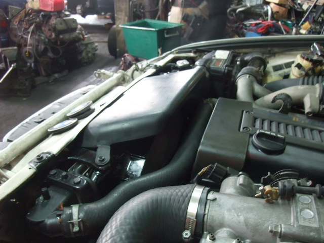

Shot of the nearly completed engine bay. Wanted it to be as 'stock' as possible.
Managed to modify the front slightly to accept the stock 1JZ air intake. Did not want too much noise from a cone type open air filter plus I feel there should be more benefit from a cold air intake plus some ram air effect at speed..... :top:
I also wanted the wiring to look like it was installed at the factory so we are reusing the M50 wiring cover behind the engine bay and I'm also locating the Toyota ECU in the same place as the BMW ECU along with the box and all of the rubber fittings so that the ECU is kept clean and cool.
