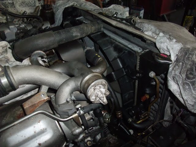

Fabricating custom engine mounting to the original 1JZ and E34 engine mounting location.
Engine installed awaiting mountings.
Everything has been cleaned up before installation. All gaskets and seals checked for leaks.
Top view. Toyota radiator installed.
why custom mounts? was told that one could get pre-fab mountings for 1jz into e34 from Thailand.
Bro Seech.. base from my experience.. i dont think your mounting cant last long.. my old one was similar to yours.. it will somehow bend.. so becareful
Thanks for the comments guys. My mechanic has done plenty of these already and no issues so far.
perharps...the sheet metal is too thin....from the previous mod....?

well it was no problem for me about the fabricated engine mounting when i went for inspection..
bro jo.. my aircon compressor got problem.. first thought it was wiring problem.. im in senawang for the moment.. so just went there to troubleshoot my problem.. since it was not that far
anakin. Puspakom requirement is that the car frame is not cut and welded to locate the engine mountings so the original 1JZ engine mounting has to be fitted to the original BMW mounting on the frame.
yeap....as seech mentioned and as simple as that......do not cut or weld onto the existing cross member,mountings or any other panel parts.......then you'll get approval......legally....
