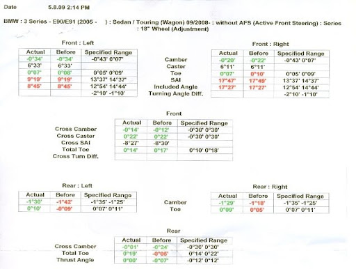

astroboy;443300 said:
These figures were taken back in March09, I wonder how's his tyre wear with those aggressive rear camber.. :eek:
Again, as I mentioned earlier, these are only recommended settings but individual drive style may demand personalized settings to ensure equal tyre wear.

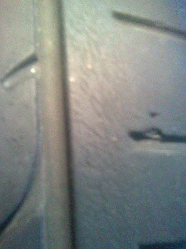

AB, the things I do for you. I went down to the basement car park after reading this post and snapped this pic just for you.
Its the pic of the rear right tyre taken from under the rear bumper area
TQ! TQ! :D This will benefit all la.. I am the one instigate only, for the benefit of all.. :p
Wah! tyre wear very even le! :top:

No wrinkles on E46F's tyre, so he's an uncle too? :eek:
Actually Rachel, wrinkles on the inside means underinflated tyres. Google it and see. :wink:

'Course I know dat bro! :) There's no such thing as wrinkles on the thread. Feathering yes, wrinkles no. Feathering is an alignment problem. Internal wrinkling is an underinflation problem.

The uncle at MPS used the word "wrinkles". Yes my tyres r under- inflated which the idrive couldn't pick up le....

Schwepps: basically what Manji told me is that i didnt check my tyre pressure regularly, thus cause the alignment to run. Then with my bad driving skill, ie: braking unnecessary ??made it worst. Anyway with this hot topic being discussed, i choose to let it fixed before changing the tyres 3 months later lo... And naively, Manji told me my front and back tyres are not of the same size :eek: boohoohoo.."i said, the bmw ppl (referring to forum) say ar...can rotate one wor" **so malu**

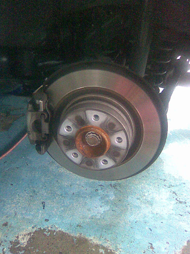

racheltoh;443226 said:
My car is in MPS auto now. They took out the tyres ..
See..so rusty
Then the front tyres ...aged badly. See the wrinkles..
Luckily the rims still ok.
