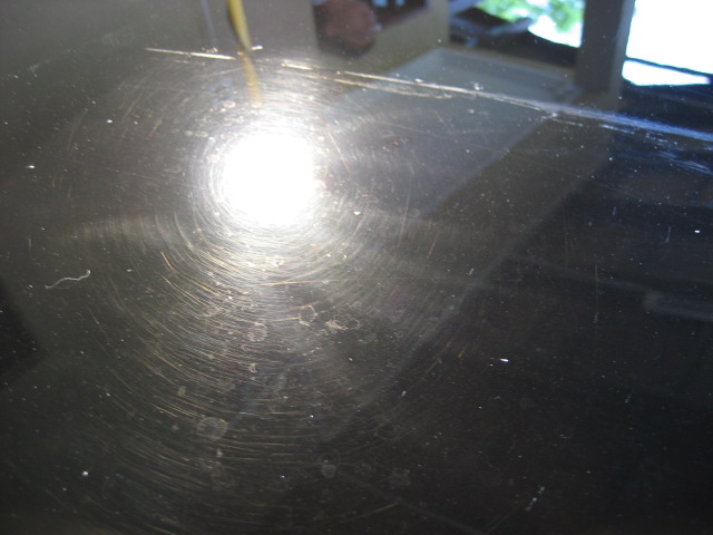

this has both Swirls & holograms...worst still terrible soft paint

this hologram like effect is actually caused by road side car wash.....chances are by hand this panel will takes u hours - est 4-5 just for 2X2 to get it mirror finish

washing swirls & buffing hologram
