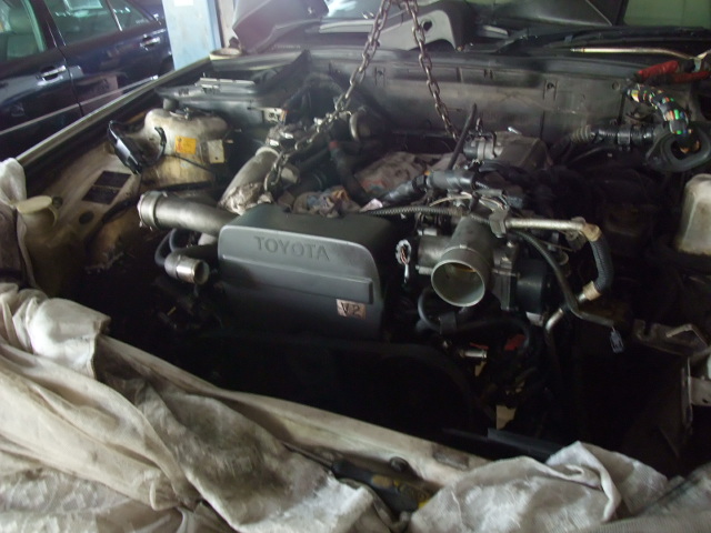

Some updates on progress....
Engine being test fitted in the engine bay before fabrication of engine struts.
What's this? Toyota.... :eek:
If you look closely, its not just a Toyota but also Yamaha...... :eek::eek::eek:

hehe....dont be surprised bro.....yamaha does the cyclinder head castings....for them....on these type of engine......besides.....yamaha is also a toyota.....i heard.....
how ever the 2jz are different......but i'm not too sure bout the vvti though......=)
There are some who say the 1J head done by Yamaha is better than the 2J. Flows better, it seems. Some even use the 1J head with 2J block to make 1.5JZ.
