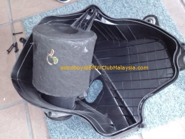

I suspect nothing was done to my air filter during my 1st BSRI service last week at the SC. At 24k km I figured the OEM air filter is pretty clogged up because if its K&N, it would be pretty dirty at 20k km. Since our air filter element is covered/protected by a synthetic wool sleeve, it's washing time! :DRefer here for instruction to open the AF box:http://www.bmwclubmalaysia.com/forums/showthread.php?t=18090"Prying" open the air filter box after removing the several T-20 screws:
Separated the sleeve from the element:
Dip the sleeve into a bucket of water premix with dish cleaning detergent:
Moving the sleeve in and out of the soap water repeatedly for several minutes and this is what u get:
After cleaning, it dries pretty fast because the synthetic wool repels water:
Slot it back to the filter element and kao tim!
Now, expecting my all time FC meter to drop from 11.5L/100km to below 11 region.. :p :DA new discovery while doing this DIY:I got this Air Filter buffer box removed by unscrewing T-15 screws marked with the red cross in the photo.
Flipping it over I noticed the interesting rips and air tunnel EXCEPT the huge green question mark:
Check out the inlet in this close up:
When in position, pay attention to the right inlet:
You see what I see? :eek:
There seems to be a small tunnel vertically aligned in the picture, connecting the main air tunnel to that little green box.
I've noticed some unknown air compartments in e34 and e46 air filter chamber also. I suppose they are there to eliminate noise? Some engineering and probably lots of computer simulations are involved just for the air entering/exiting the air filter chamber.

In the M5 provided by the above link is actually the filter element, its just replacing the element with a conventional element.
Replaced with this:
This is taken from my car 3 months after purchase.. the sleeve may appear dark but that's just the contrast in the photo. There's no dark charcoal grain in side.
Our E90 320i element is also yellow color ma. So no additional element, just synthetic fabric sleeve:

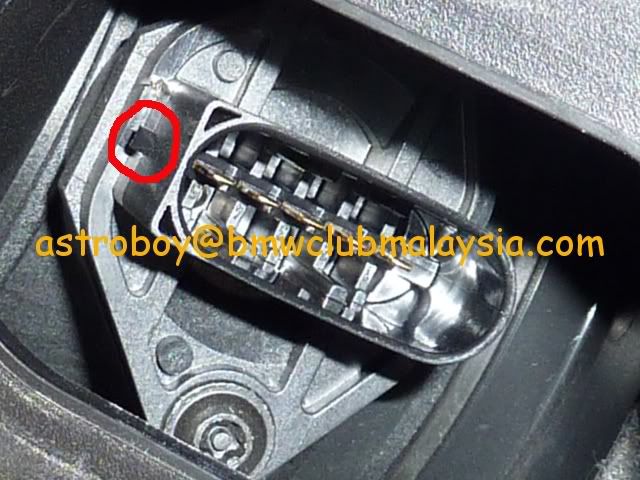

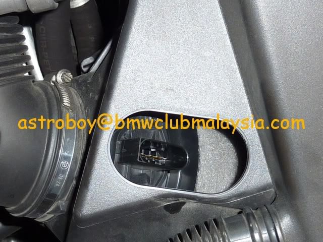

I received the following PM from a forumer from Wellington but I can't reply due to the following message:
"agoodkeenman has chosen not to receive private messages or may not be allowed to receive private messages. Therefore you may not send your message to him/her."
agoodkeenman said:
Thanks for your guidance re opening the air filter box on a 320i. i am having trouble working out how to unplug the air sensor socket after lifting the rubber plug.
Could you please describe how to unplug.
regards
agoodkeenman
The socket is similar to the following:
You will notice 2 stubs at the side. U have to press both side of the plugs to un-hook the stubs in order to pull out.

Update:
This is where our E90 Air Mass Meter connector socket is located.
Close up, I highlighted the stub where the connector will fastern on.
This is the connector, check out the fasterner hook at both side.
Press here.
This is how the hook spread open.. :p
