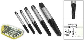

GUYS NEED HELP!!! Helpp!!! i just ruined the groove of the inner 8mm? hex screw groove gone... this is the one i meant...
Anyone know a way to open a ruined Hex nut???
u may try this one thing "broken bolt remover".can get it at hardware shop.cost about rm20-rm30....
how to use? drill a hole on the broken bolt, later pull it by this remover. the remover thread is reverse to normal bolt thread

I just googled it yesterday and still waiting for time to go shopping for it... but thanx ! Got the parts---> window regulator
this "broken bolt remover" :- remove "skru patah" then u can use same screw/bolt.... this thing not ruin ur original thread....
ie : original bolt/screw is 10mm as pic shown, then after remove the broken one then can easily
put new 10mm bolt/screw.
wish u luck on ur DIY....
Thanx M3addict... well in the end ive solved it much simpler ... i just grind the nut so i can grip thm with pliers and turn it...
