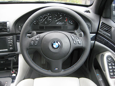

DIY SMG steering wheel retrofit DONE!!!!
Not that hard to do, I had my car for less than a week and I know where things go. Bit hard trying to pop out the airbag though, but once you know where to push its easy as hell.
The feeling of changing your gear on the steering is priceless! Definitely recommended if you want to feel the potential of the car (have to be noted that this is nothing different than changing your gear up and down with the shifter, but on the steering its so much easier!)
Pics as below
The new steering wheel. Love the feeling of the soft and supple grip of the new leather

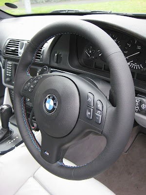

Side view showing the tri-colour stiching
DEFINITELY LOVING IT!!!!!!
wow...bro...that's a lot meatier to look at, feel it and hold onto.:top:
How much did you fork out for this retrofit kit?

Bought it from a guy on ebay, but did the transaction off ebay to save cost on both side. He's from USA.
eBay price: $745 for steering, $225 for retrofit kit (this include the slip ring switch and the wiring) and $49 for postage.
Price off ebay: $699 for steering, $199 for retrofit kit and same for postage.
As he did the transaction off ebay he could declare the value of the item as $85, to minimise import tax. If you buy it from him on ebay he would have to declare actual price (nearly $1000, imagine the difference in import tax).
Fitting instruction included but quite hazy. He only points out where things should go without telling you how to get there. But there's plenty of information on the net on how to release the airbag, how to remove the steering wheel and so on. Once you have all this info at hand its quite easy to do and straightforward. Plug and Play. If you dont like it the process can be reversed without any trace on your car. Same procedure on E46 as its the same wheel.

yup, mine's m-sport with the bigger airbag. this steering is much nicer. Thicker too.... great for grip

BTW airbag NOT included. Only works on Steptronic post 1999.
is the SMG 'M' thicker than your previous one (1st pic)? It certainly looks thicker, or just the new leather is fooling my eyes

Btw it is thicker than the original steering, but I think the original steering was much thicker when new (probably the same as this new one) because it was a M-Sport wheel as well, but got thin with the pressure from the hand through the age. The new leather is really soft and easier to grip, melekat to your hands la.

lor not like that la, its melekat in a good way. I mean if old steering, it becomes a bit shiny with age, like it was polished and when you're cornering you have to grip the steering tight otherwise it'll slip. New leather its soft and still have its patterns/grains so better grip. when cornering just put your hand on the steering, dont need a strong grip.
