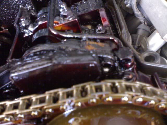

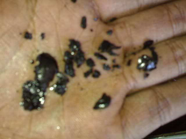

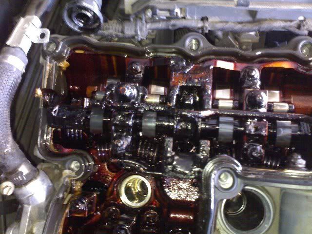

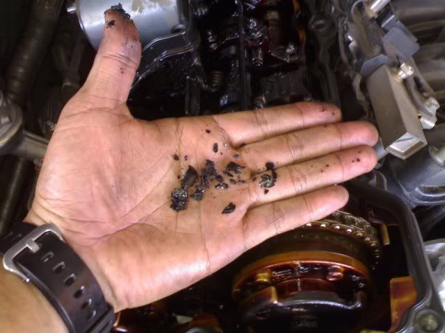

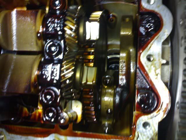

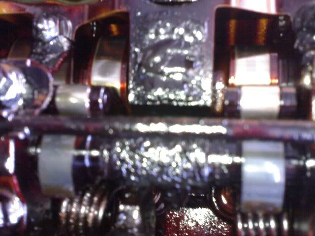

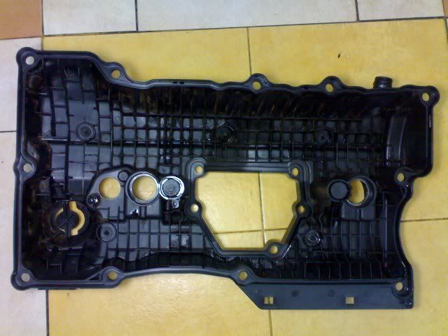

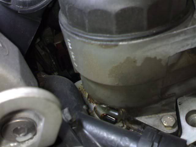

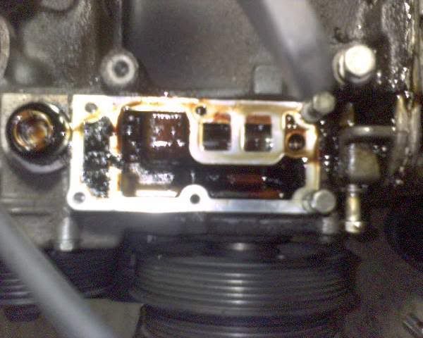

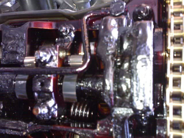

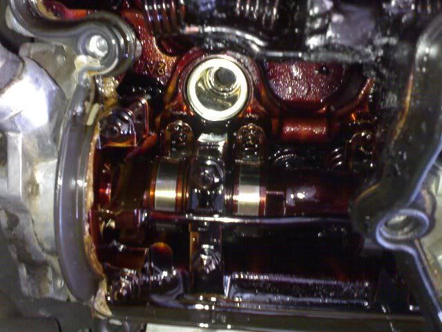

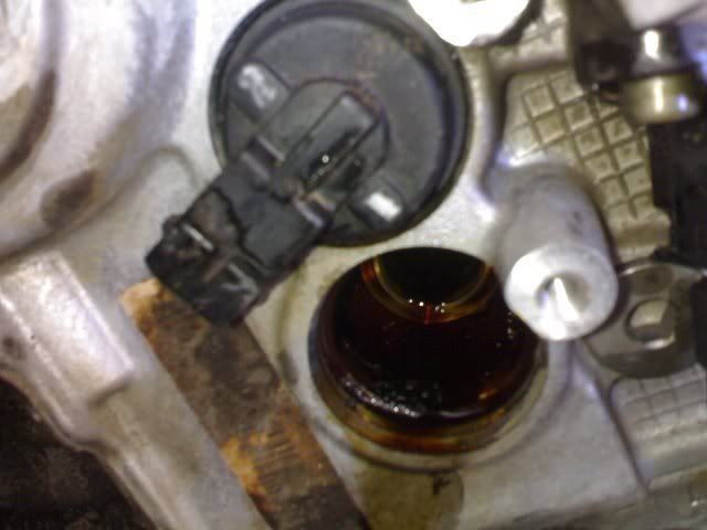

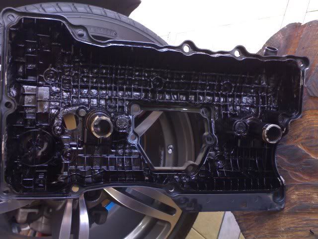

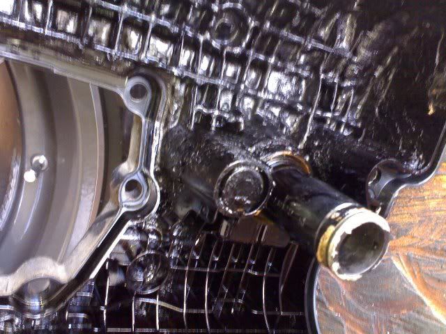

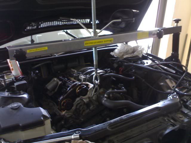

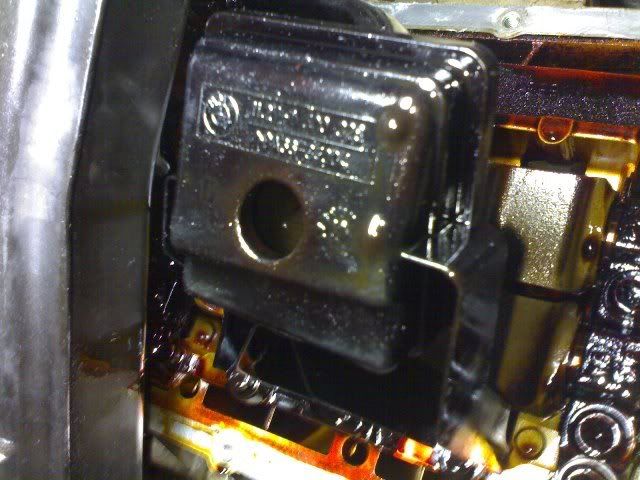

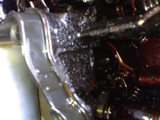

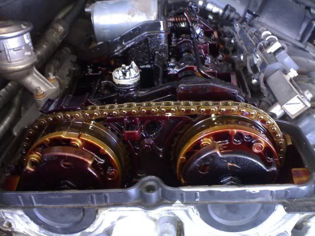

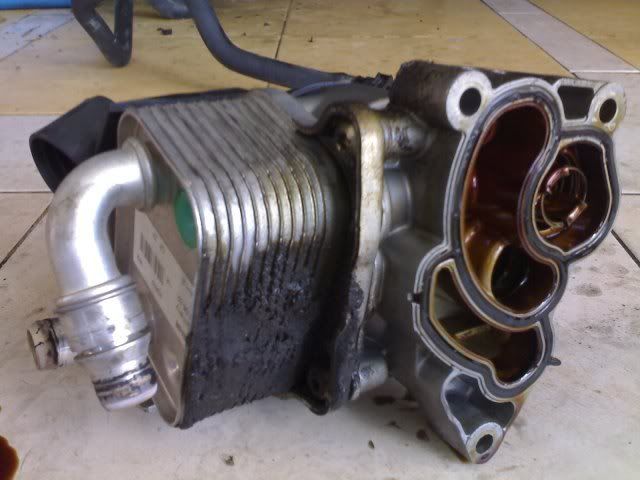

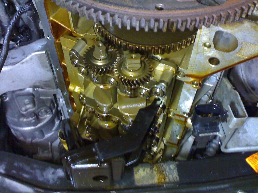

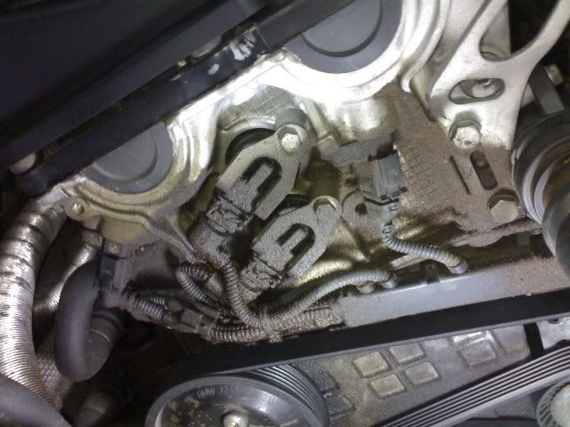

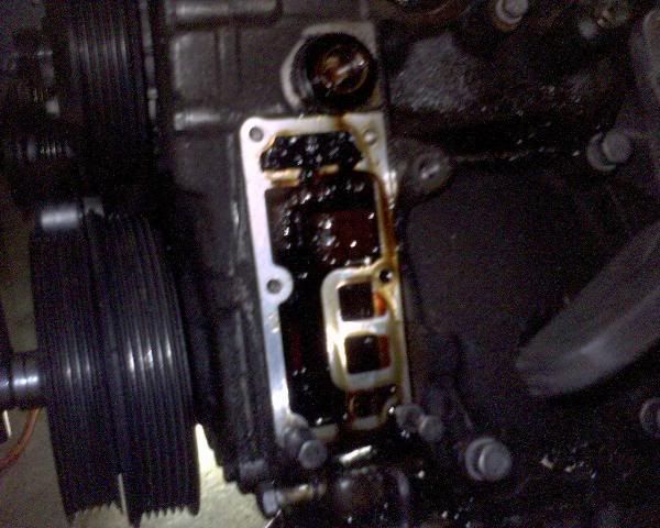

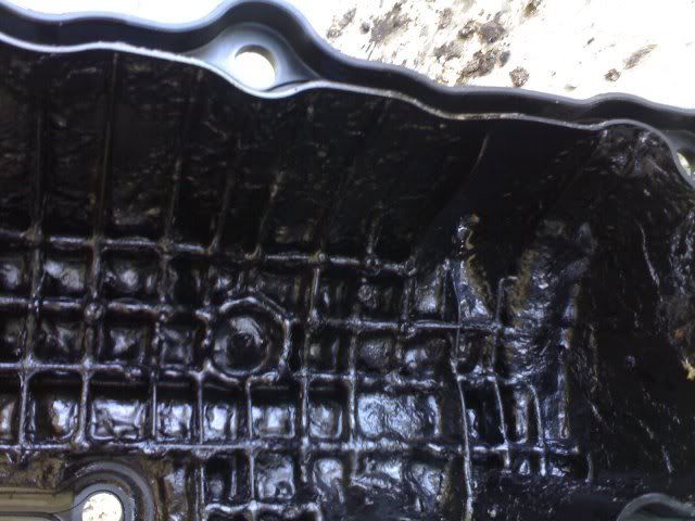

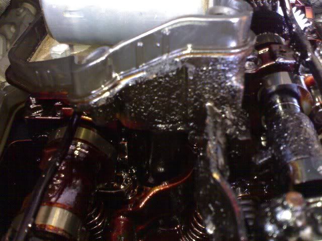

This brings back memories. There was this E36 318i engine that was as dirty as this one. It was so dirty and clogged the engine oil upflow channels to the timing chain. It made the timing chain dry, dirty and noisy. The car could start but the noise from the engine was so loud like it was running without lubrication. The owner had to tow the car to my friend's place.
When we removed the valve cover, the engine smell like was bad and super strong. The smell stayed on our hairs and shirts by the time we were finish removing the engine head.
It took us several rounds of chemical wash and rinse plus scrapping to remove the dirt from the engine parts. In fact, when disassembling the engine, some areas had to be scrapped and remove the dirt to get to the nuts and screws.

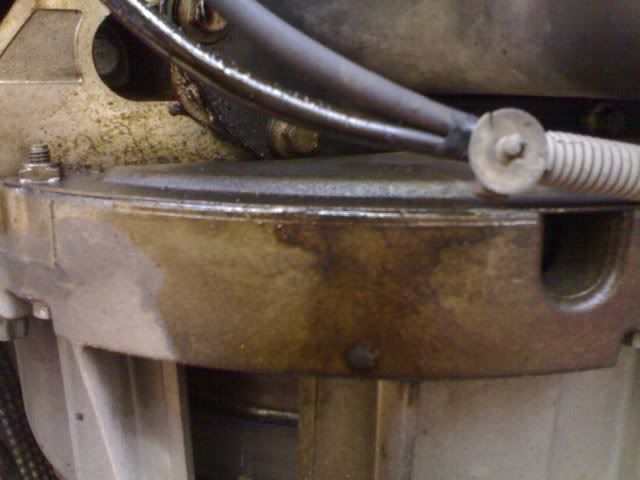

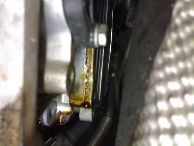

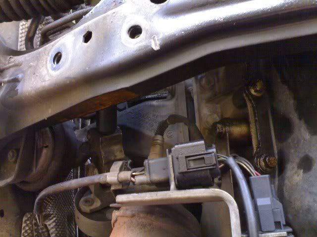

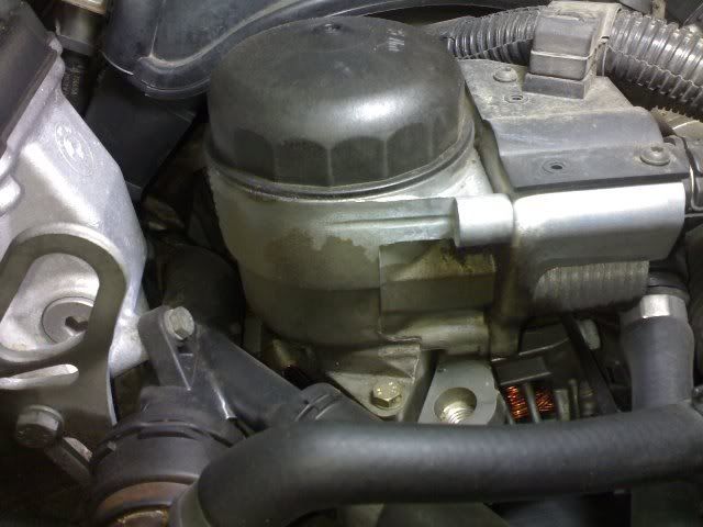

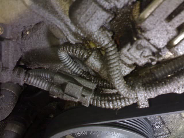

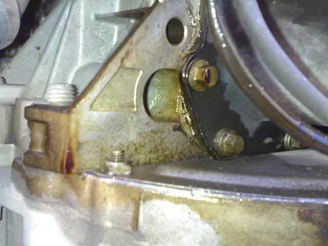

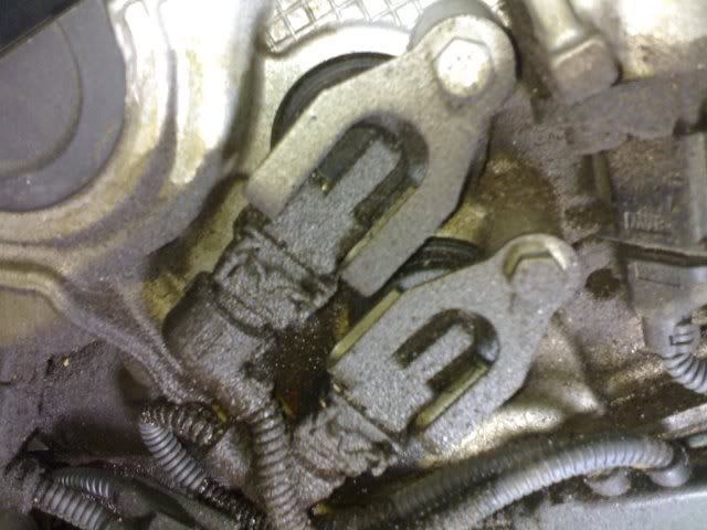

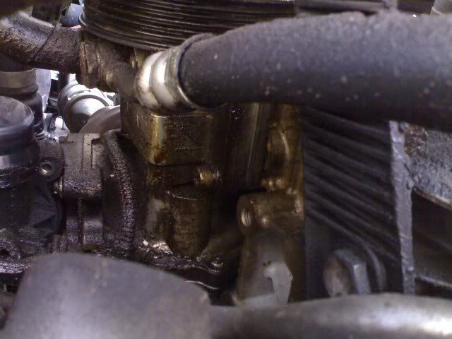

Wish i had read this thread earlier ..... over the past 6 to 9 months, i was constantly sending the car to fix this and that leak .... car is 5.5 yrs old and at 105k kms....318i 2.0lt valvetronic model.
Just today i had the engine valve cover replaced ...ouch, expensive. The leak was not due to the valve cover gasket, which was also replace about 1 year ago.
Even my engine oil dipstick thingy leaked oil! Others are such as timing oil seal, oil filter seal etc etc.

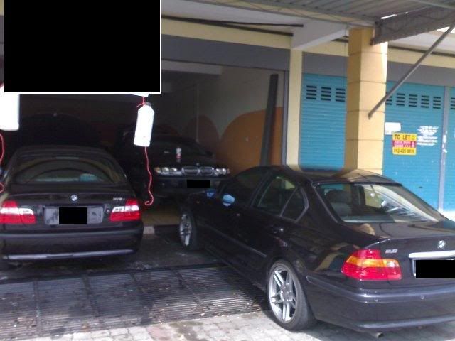

Hi Bro
Just want to clarify... it is not my shop...I do not own a shop.
I hang out there to help a friend, to learn and fix cars as a hobby.
Have not done much fixing since I got back from the states 2 months ago... busy like a bee with work.
No need to test my knowledge la... I am not a mechanic by profession... I only share what I learn only la.

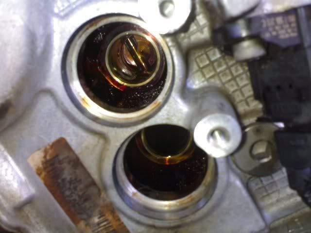

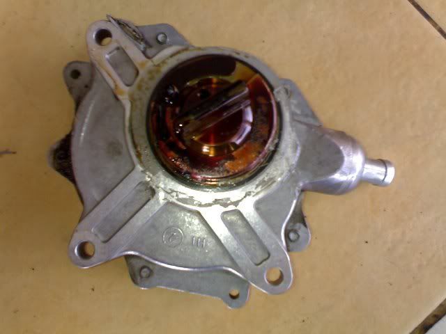

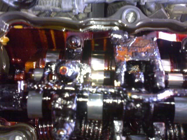

planta;297256 said:
just to share with you guys .. the engine pictured earlier had to be top overhauled as the engine oil was missing about 1.5 liter every 3 days... the odd thing was that there was no leaking and no white smoke ... we suspect the fume was filtered by the catalytic converter.
I was not present when they did the top overhaul but according to my friend a few valve seal was worned out plus due to the extreme dirt .. a few air holes in the engine head were blocked. They had to drill the hardened black dirt to clean it... I wish I was there to experience fixing this and taking picture of this and share in this forum... so... change you engine oil regularly guys...
planta
