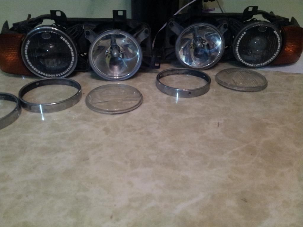

Now Lets continue on the Part 2 RGB Angle Eye + Smoke Headlamp project......
1. You can see on the past project I only install on the low beam and smoke it. Not its comes to the High Beam installation..
- Here my headlight remove
- Last project im using lighter, now im upgrade by using Torch so it will be fast heating.
ps: Some people using other method by using Oven or Hot Air Blower. But im using Torch and its just the same effect and cheap.

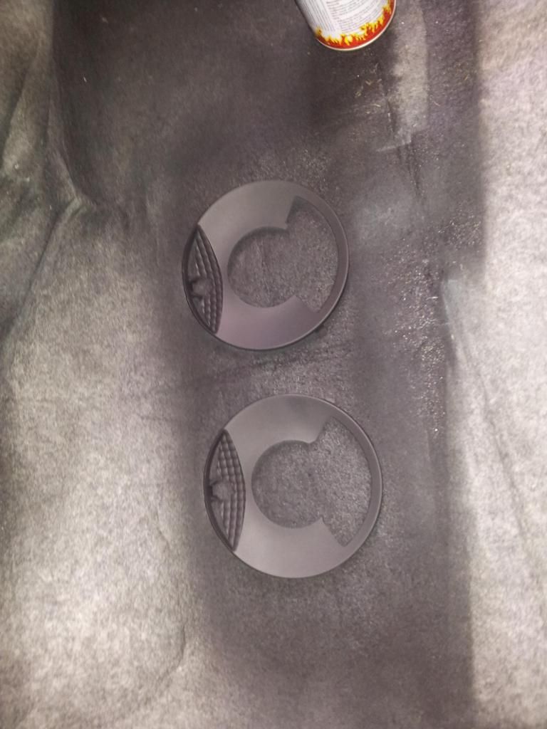

2. Alright, last project I had print the diagram for High Beam Smoke but I cancel on doing it... Here the result of it...
- After its got paint
- Since its to thick that y I cancel on doing it. And I had in mind what should I do on the High Beam (that going to be showned on the next project on (EURO STYLE HEADLAMP) )
3. Here it is after the high beam glass been remove. Its took short time by using torch and easy. I recommend you using it, get it for Rm15 only!. Cheap right? Better than buying Hot Air Blower that cost RM 100 plus.
