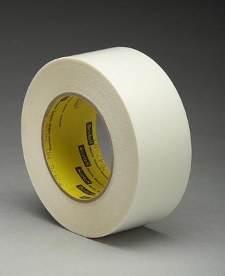

the tape
3M Squeak Reduction Tape 5430
http://www.amazon.com/3M-Squeak-Reduction-Transparent-0-18mm/dp/B0013HBOSG
3M 06356 Squeak Reduction Tape 5430, 06356, Transparent, 1 in x 3 yd 7.0 mil (0.18mm), 2 Pack 3M is a diversified technology company serving customers and communities with innovative products and services. 3M is committed to actively contributing to sustainable development through environmental protection, social responsibility and economic progress. 3M Squeak Reduction Tape 5430 Transparent, an ultra-high molecular weight polyethylene film tape with an acrylic adhesive, having low coefficient of friction. 3M Squeak Reduction Tape 5430, used in the automotive industry to help control squeaks and rattles due to vibration or wear of metal and plastic materials. Provides excellent abrasion resistance. 3M 06356 Squeak Reduction Tape 5430, 06356, Transparent, 1 in x 3 yd 7.0 mil (0.18mm), 2 Pack features: Adhesive Material: Acrylic Backing Material: UHMWP Color: Transparent Length: 3 Linear Y
