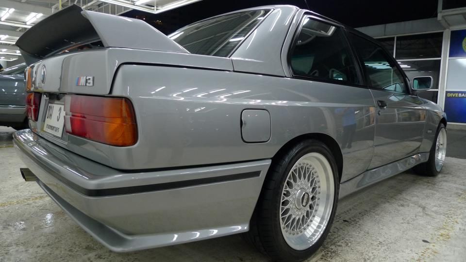

A gathering of Bangkok Classic Car events - 8th Dec 2012, I wish I can join

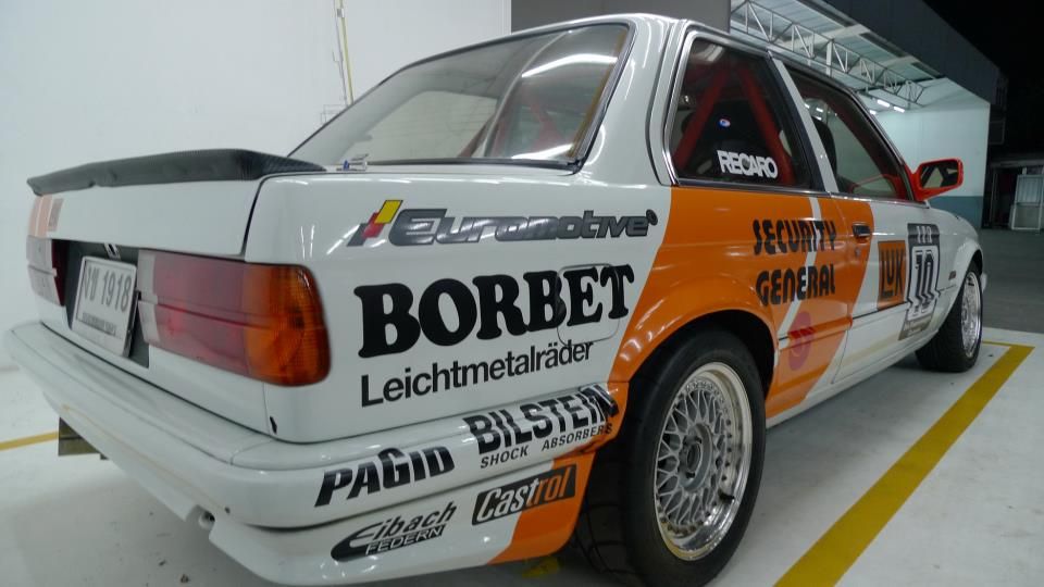

those Thai M3's appear to be showroom condition. however the best E30 in Malaysia is without any doubt the white one (with red & blue stripes :tongue: ) i saw yesterday :wink:

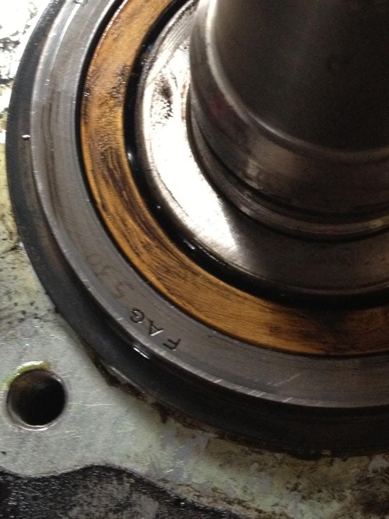

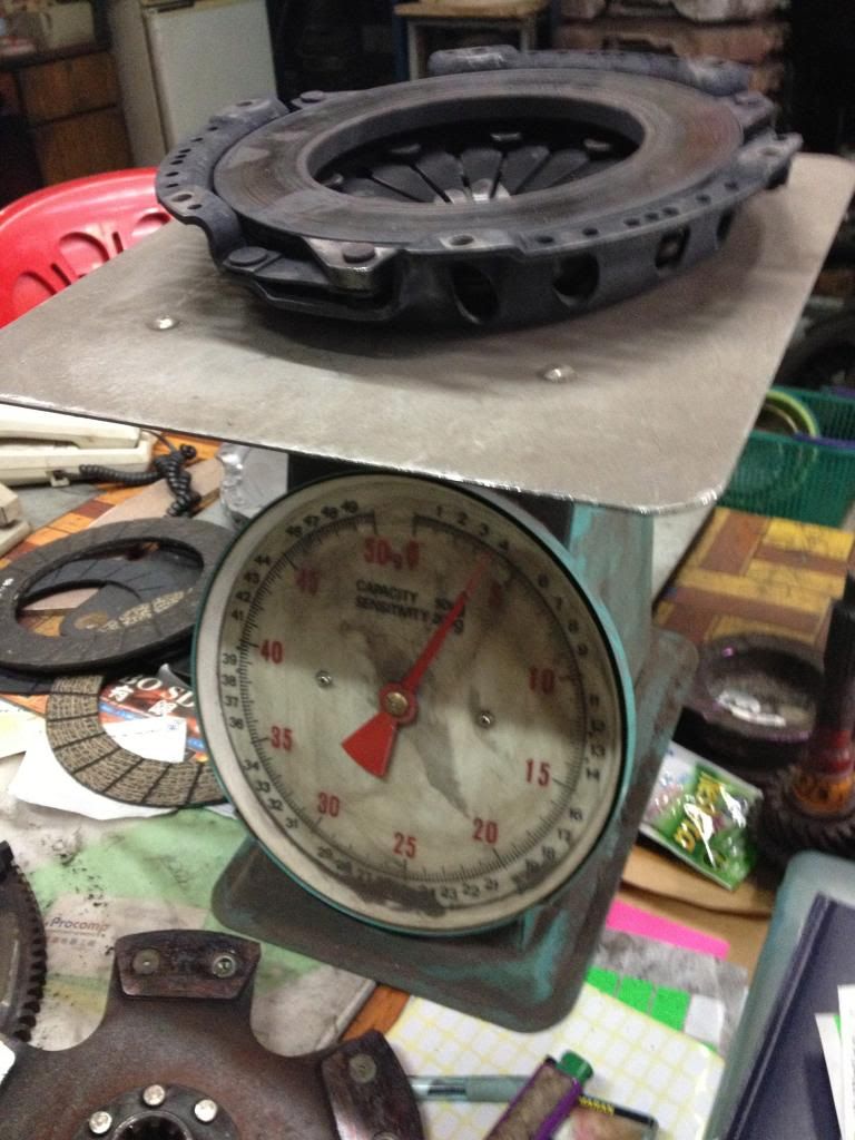

Clutch was burn out...and time to change the input shaft bearing and shim too due to the Gretag rattling "noise"
The sintered clutch left with 7mm thickness...
Also changing the Input Shaft Bearing 23 12 1 209 323 and shim 2

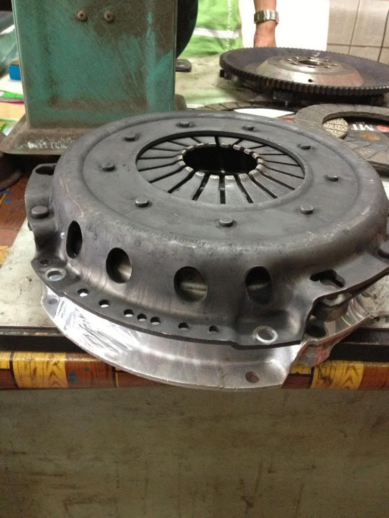

Sport Pressure Plate
Sport vs Stock
Lighted Flywheel

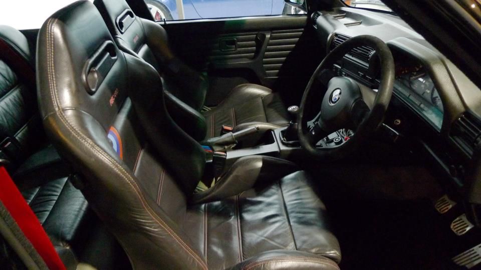

Yes, converted for the driving pleasure in Bangkok.. It's not a easy task for the conversion...unless you are doing this...
These Custom made stainless steel Exhaust Headers use a longtube manifold design, and are guaranteed to give a performance increase to your BMW e30 M3.
They are ideal for use in e30 M3 conversions LHD to RHD. The LHD > RHD e30 M3 Exhaust Headers join with the factory exhaust system.
