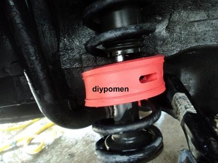

Ive solved my uneven car by using spring buffer... After the mech measured my ride heigh left and right rare he install this:
Problem solved...

I recall reading from this forum previously that the reason for the uneven ride is because UDM is engineered for left wheel drive and the right side is naturally lowered to compensate for the weight of the driver on the left side. When it is converted to right hand drive, no weight compensation is done and hence the UDM will weigh down on the right side. Was at SpeedWorks today to wash my K&N air filter and the chap confirmed this theory. He did mention that the damper as installed above can actually damage/break the spring and the best option is to install adjustable spring.
When I was changing to Titans, the uncle told me that as well, and he compensated for this with the new set.
So naturally it is supposed to sit lower on the rear right set. Interesting. How did the guys at Titan compensate this then? Lowering the left rear set?
Either way the bushes are due to be changed as cracks can be seen clearly. Anybody know if this can be done given the abs and springs are still in good shape?
A friend shared his experience having a failed absorber and still drivig the car. He damaged his drive shaft and had it replaced. What could have been a simpler and less expensive job to replace the suspensions came to be costlier. He drives an alfa 147 btw. Anybody can share other consequences of a failed absorber?
Not sure how they did it but he measured the ride height on all four corners, to show me pre and post install.
LOL... Of course he said it will break the absorbers so he can sell you a new one... Unless you potong spring and use dampers then its another story
Basically what the dampers do is just push the spring about 2 cm up to make sure the car is level... In Logic and also some mech advice... the dampers actually helps the absorber not the otter way around...
