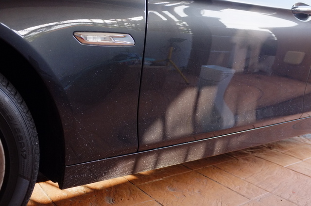

The usual dirt and grime.
Easily removed with Optimum No-Rinse (ONR) and the Optimum Opti-Mitt.

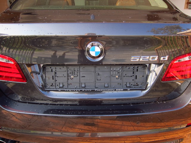

The rear license plate was removed...

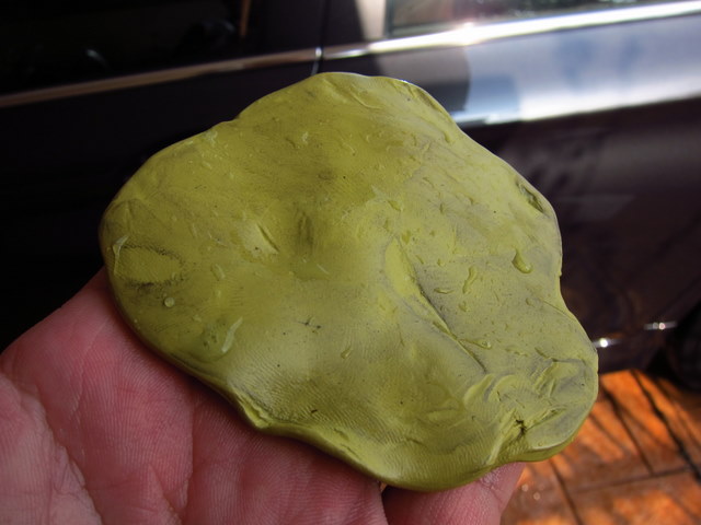

Claying with Optimum Opti-Clay.
As expected, the surface was still relatively clean but the clay did still pick up some contaminants on the surface.

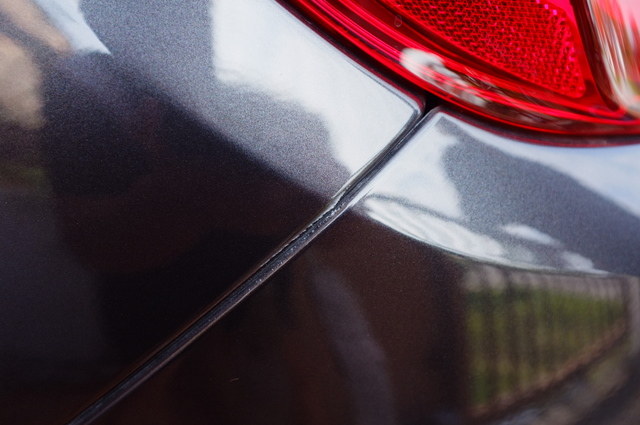

The diesel filling flap was still clean...
But there was evidence that this ride was either polished or waxed before.

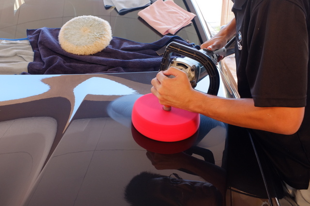

As the paint was in pretty good shape only a light polish with Optimum Hyper Polish and the Optimum Double-Sided Red Foam was required..... or so we thought.

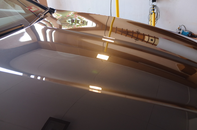

Upon closer inspection of the front hood after polishing, there were some deeper swirls and RIDS still remaining, so...

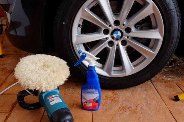

Out with the Optimum Hyper Compound and the Optimum Double-Sided Twisted Wool pad.
Mun at work..... again.

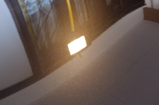

Most of the deeper swirls and RIDS were removed after compounding but there were still a few very deep scratches remaining...
Which required some wet sanding to remove.

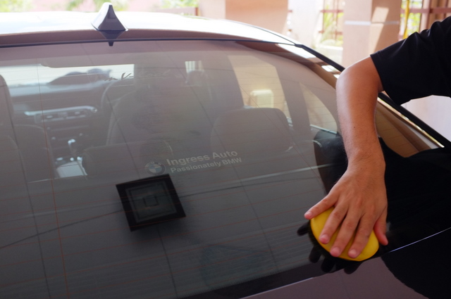

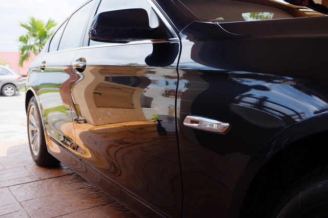

Mun at work.... Coating with Optimum Opti-Coat.

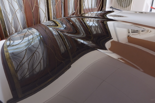

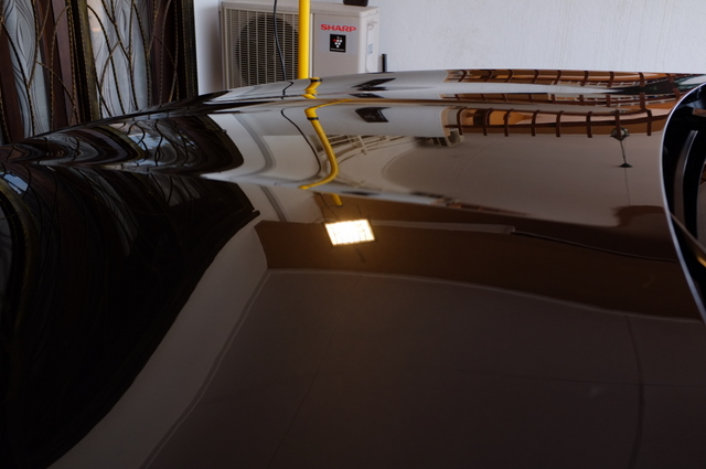

After coating.... Nice deep gloss and shine.
Full-sun shot!!!
Reassembling the rear license plate.

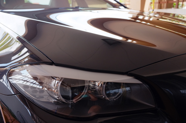

Awesome reflections!!!
I do like this shot of the F10!
