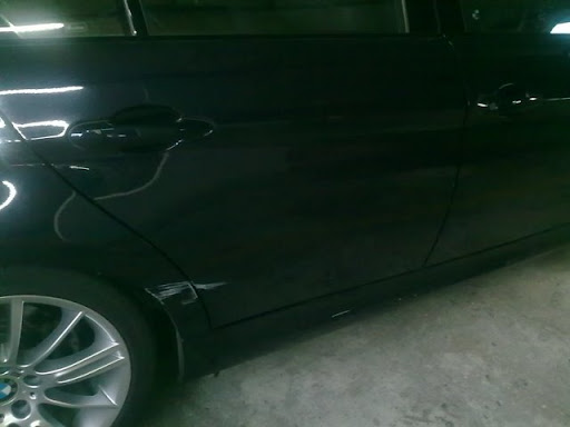

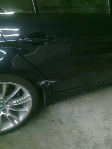

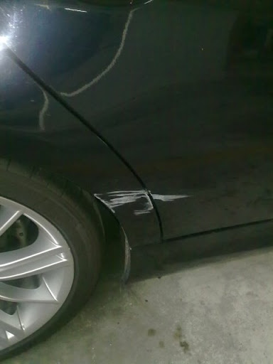

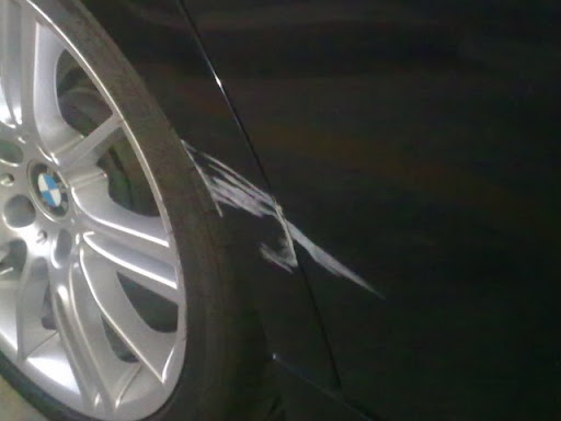

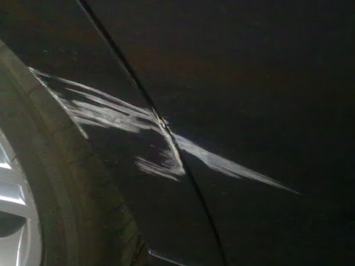

RM1200 was quoted by German doctor name Ingress. They said need to respray the whole right door+bumper??
The monaco blue by BMW..is it a special blue or most ppl can match it??
Yes, posting pixx next.

Can see besi or not? Mine also has something similar but I just polish off using Meguiar ScratchX.. ding still there but a lot less obvious than yours..
BTW, your 193m pretty "worn" le, not much better than mine.. must have left your "marks" at many places.. :p
Need to spray 2 panels, rear door and rear quarter panel, most likely but the RM1.2k job would definitely be a half car paint job for better color match.

Rachel, most of what you see is the white paint that you picked up from (the wall edge?) that you kissed :) I would do like Astro: rub off the white paint and see if you can see undercoat or metal (doubt it) Then polish like mad with a good polish, and see if it's still noticeable. If not very noticeable, leave it until you get a really big prang. Small scrapes and doinks happen all the time, and even if you don't cause them, others will in parking lots. If really cannot tahan, just do a spot repair for a couple of hundred. That low down in the body no one will notice.
