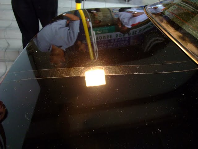

Actually this picture illustrates the main difference between an ROB and a rotary.
The strip in the middle was taped off so that is the condition of the original paint. The top portion was done by my new friend with a ROB while I did the bottom portion with a rotary.
As you can see, the ROB did correct some of the minor paint defects but was unable to deal with the more severe problem which required a rotary. If your car isn't in this bad a condition, a ROB should be more than sufficient.
