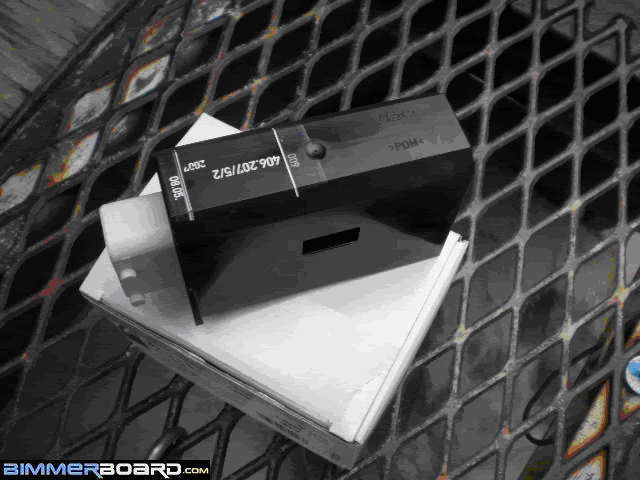

Jerman;523878 said:
Here is a clearer picture of the actuator.
Borrow the picture from BimmerBoard.
