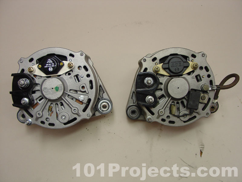

as per the image,need some advice, what is the different of the second alternator having a small black plastic box, as my original unit comes with it, one more thing is even with a charging alternator, does removing the negative cable from the battery, the car will die of slowly........charging reading is 13.6V.

but you must check with the volt meter between 2 points, one at the alternator output, and the other at battery cable spiltter. see the difference, should be reading at 14.2 above, not less. if at the alternator, then change it, not good recon model. if not then it's the cable.
btw, the above two alternator is the same, one older one newer. just make sure you have the pin outputs same.

How can i check the charging output from the alternator, how should i tap it? as from the battery i can tap the negative and positive terminal, should i tap on both of the screw in the black bracket area as per the alternator picture earlier?
The black colour box is of no important ?
