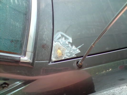

Rear driver's side door had a corner that rusted to a biscuit, so it was cut out and fresh steel was grafted on.
