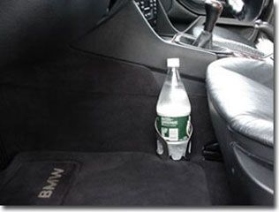

NOTE FOR BMW E39 5 SERIES: Although it can be positioned more to the front or rear if desired, an ideal location is above an area on the floor where there is a slight depression, just below where the rear edge of the carpeted bolster meets the plastic console (as shown in the picture).

Sorry to hijack thread, I bought 2 for the e39 from bmw7899, and do not like how it sit in the car and therefore would like to dispose it at a discounted price of rm 80. Anyone keen, call me at 0162011091
It is as per your pic, but you would need to move back a fair bit, mine passenger seat is with the first aid box..

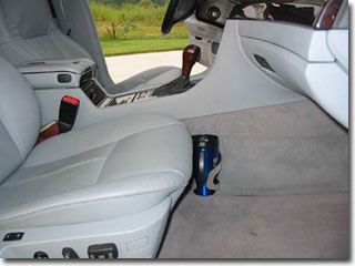

Spent half hour to get it fix to the car finally.
I think i fix in the different location if compare to what vendor show in picture.
I took out the trim panel (item #2) and slot the arm into the trim latch. U have to strait the arm a bit so the holder fit perfectly.

This is the picture after all.
OK, confirmed the location is different, but i more than happy to let the holder sitting there. More solid location and convenience to me.
Centre console - BMW parts catalog
Nope, i meant the hole below the point 7 which is for the trim latch use.
But the hole is too small to accommodate the holder .. did u extend the size of the hole by cutting it? or just squeeze in?
I didnt cut anything..i just straight the holder arm and slot it into the hole, nothing else to do.
