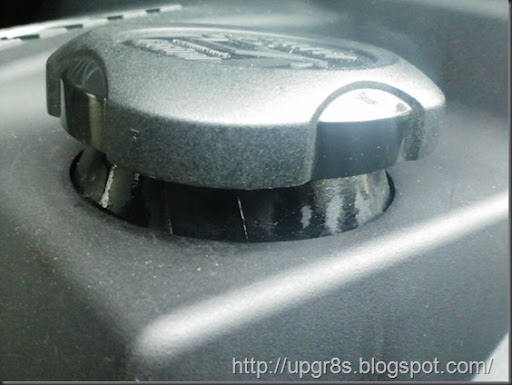

Sometime it's the oil cap gasket. Check out my blog.. some useful tips there..
http://upgr8s.blogspot.com/2013/06/bmw-e90-diy-rocker-valve-cover-gasket.html
Mine suffer from leak and serious oil loss too.. I recently changed my rocker cover gasket, refit my oil housing gasket and flipped my oil cap gasket. If still leak, am suspecting the eccentric shaft sensor O-ring [item 7 below]
