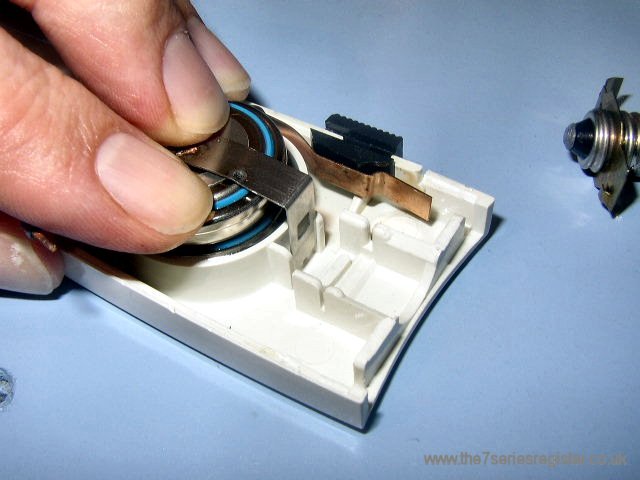

Believe it's batt too. But i'm having a tough time figuring out how to open this blardy 1 piece looking plastic. No sign of two points coming together...where to begin also dunno.

Care to explain how you manage to rip it apart Vince?

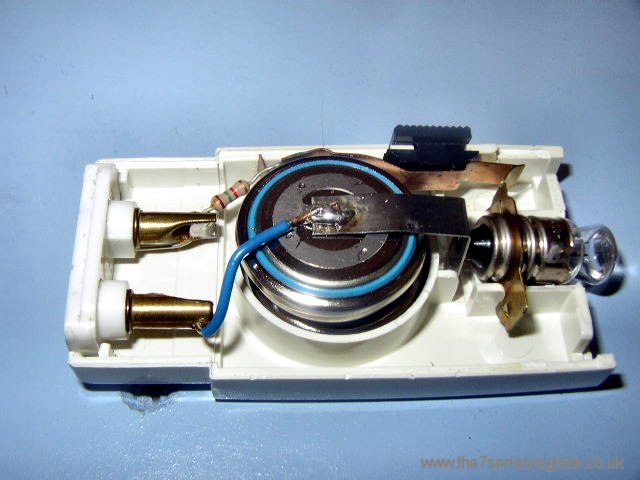

Sorry, did not notice the resistor in series with the charging terminals.
So most probably, the battery required is rated at 1.2VDC instead of 2x6V battery.
But then again, from this pic, the battery are stack up or in series.
Notice the 2 batts in there.

OK my bad.. Looking at my Malaysia version hardcopy catalog,
here is the answer.. Stock number should be 325-2872
